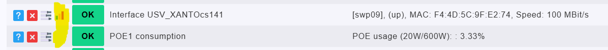

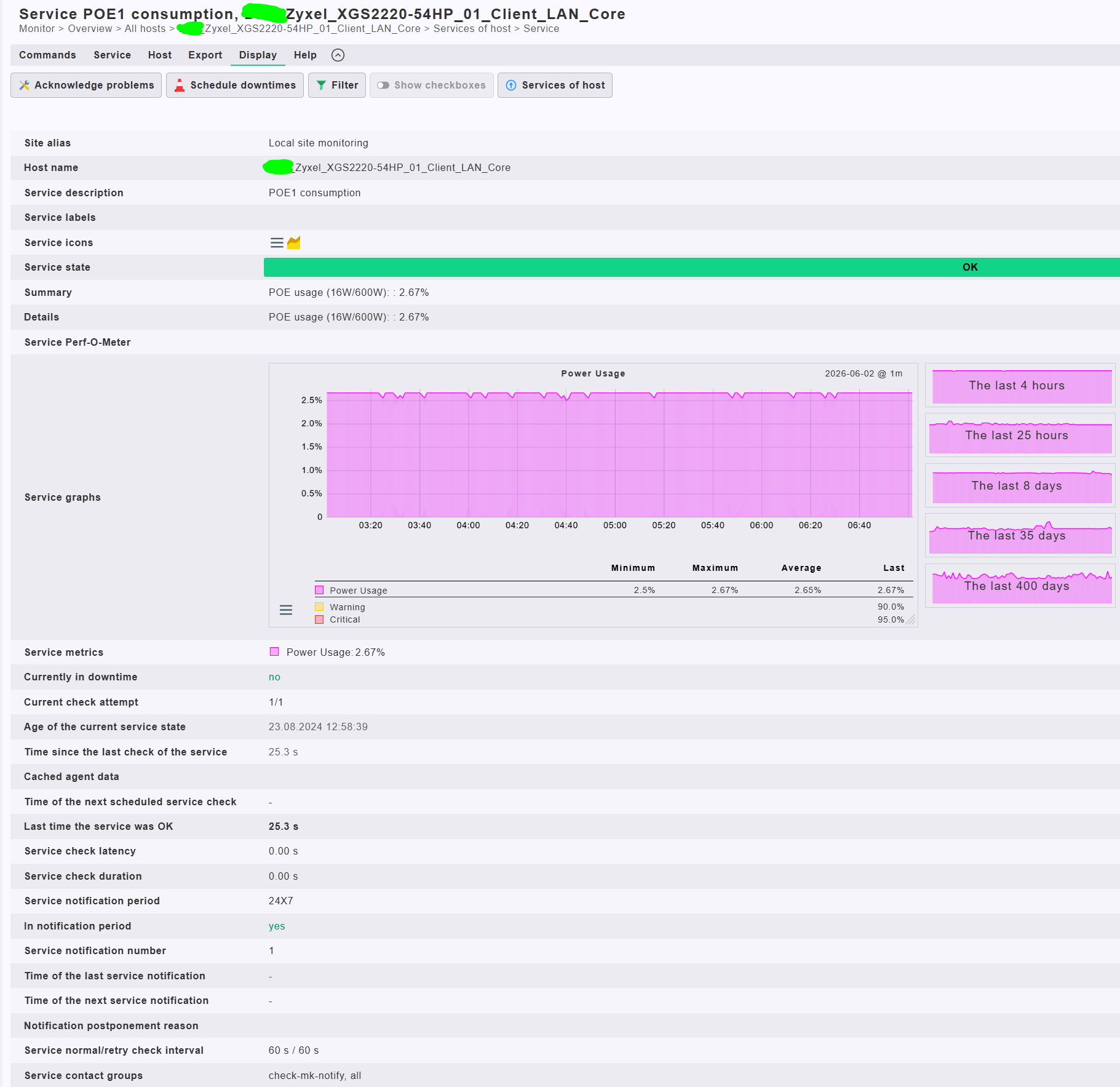

BenOn inventory of our Zyxel switches the service "POE1 consumption" is found automatically.
In this service the Warning & Critical thresholds are set automatically at 90% & 95%, which is fine.
For one, it would be nice to be able to adjust those thresholds, but I can't as there isn't the "adjust parameters for this service" button available.
But my primary idea is to have (ideally configurable) thresholds for the lower minimum limit, so that it goes to a warning state, when the PoE consumption goes below x% or to 0. Which then tells me there's a problem with the PoE part of the switch, because not all PoE phones vanish by accident. -

Thanks, that helps a lot! We really appreciate the description and the screenshots!
