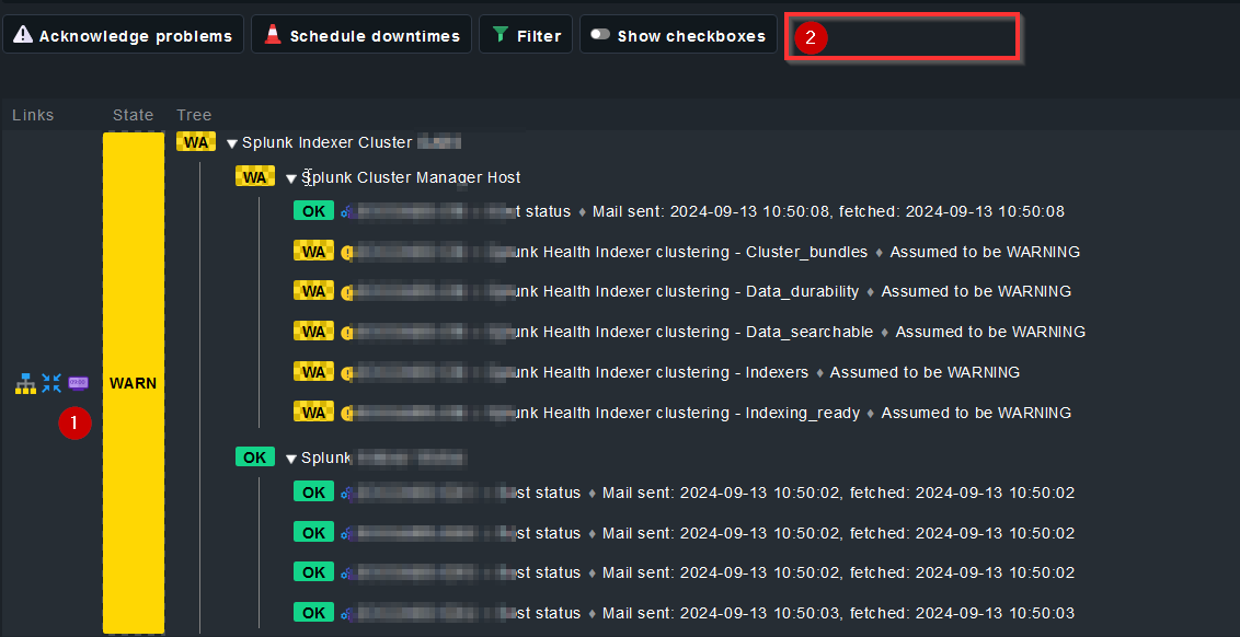

GerdI think this would make sense, at the moment, I (as an admin) sometimes rather login via ssh and remove the ~/var/check_mk/web/$username/bi_assumptions.mk file, then clicking a dozen times. (which is of course not an option most users have)
I could imagine either resetting the assumptions for one BI (see attachment with an icon at (1) or which would also be totally fine, just remove all assumptions as is done when deleting the file, then a button at (2) might make sense.
(I guess 2 is a lot easier and predictable for the user as bi_assumptions.mk doesn't store assumptions for each Aggregration separately but simply an assumed state for each service/host which can be part of a multiple aggregations.)
