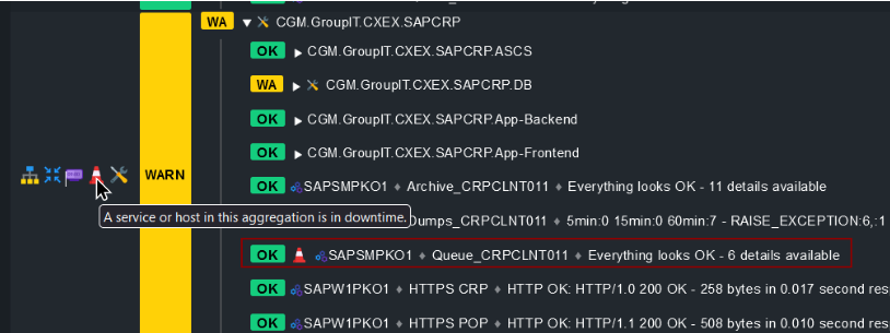

MarcoHello Mohamed,
here is an example picture where that feature would be a perfect fit.
The downtime on the aggregation should not be set automatically just because one subservice is in downtime.
Hope that makes it more clear.
